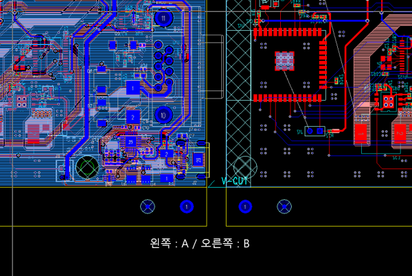

안녕하세요. PADS 사용시에
2개의 다른 PCB를 하나의 거버로 만들기 위해서
reuse 기능을 활용하고 있습니다. 해당 기능을 이용해서 A와 B 보드를 하나로 옮겨 붙이는건 성공했습니다.
그런데 붙여진 B 보드에 GND Copper pour를 씌우고자 하는데 진행이 되지 않습니다.
A의GND 네임은 "GND"이고 B의 GND 네임은 "GND_Z"로 구성되었습니다.
어떤 설정이 잘못 된건지 정보를 찾을 수 없어 이렇게 글 남깁니다.
알려주시면 감사하겠습니다.
ED&C |안녕하세요, 이디앤씨입니다.
아래 정보(MG22346)를 확인 바랍니다.
PADS VX.2.4 and later:
The copper plane must be in Pour Outline mode in order to add it to a Reuse definition. The copper plane cannot be flooded or in Hatch Outline mode when the Reuse is created.
Type in the modeless command PO to toggle the copper plane outline mode. The status bar should display "Show Pour outline = ON". Alternatively, go to Tools-Options-Copper Planes-Hatch and Flood and set the radio button to "Pour outline".
The copper plane will not come through in the Reuse if it is not in the outline mode prior to creating the reuse definition. In your Filter add a check mark for only Parts and Shapes. Area select the parts and planes you want to define as a reuse, press the F5 key on the keyboard to select the associated pin pairs for the selected components, RMB-Make Reuse.
PADS VX.2.3 and earlier:
The copper pour must be in Pour Outline mode in order for this to function; split planes must be in Plane polygon outline mode. The pour/plane cannot be flooded or in Hatch Outline mode when the Reuse is created.
Type in the modeless command PO to toggle the copper pour outline mode. The status bar should display "Show Pour outline = OFF". Alternatively, go to Tools-Options-Drafting-Hatch and Flood and set the radio button to "Pour Outline".
For split planes, type in the modeless command SPO to switch to split plane outlines. Alternatively, go to Tools-Options-Split/Mixed Planes and set the radio button to "Plane polygon outlines".
The pour/plane will not come through in the Reuse if it is not in the outline mode prior to creating the reuse definition. In your Filter add a check mark for only Parts and Shapes. Area select the parts and planes you want to define as a reuse, press the F5 key on the keyboard to select the associated pin pairs for the selected components, RMB-Make Reuse.
